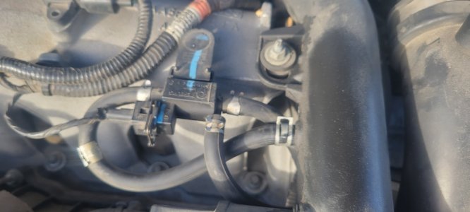

FOUND THE ISSUE
it was a vacuum line that came off, i assume it checked for balance between the two turbo
The line is one of the 3 in the photo on the top left of the engine
