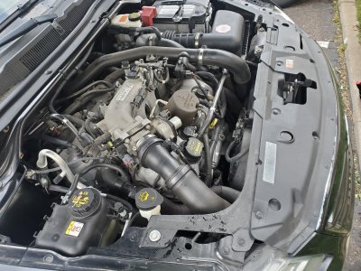

Got any pictures of the car?
Had a ****** weekend and didn't get a chance to take any, dont see how that is gonna help this situation what are you looking for?

Really just anything out of the norm in the engine bay or something. Just trying to get as much info as possible to help you out.
Ok give me a bit let me try to run out before work

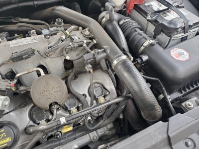

I dont see anything else other than the noisemaker delete02dbcadf7056d7613fce7322984c1d5e952d0609581bf291d090aaa4c4690d74

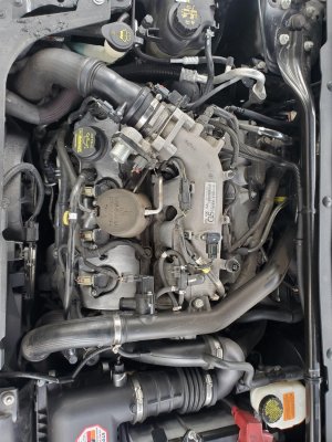

I believe this is the recirc line that he removed to have the blow off sound?8e94c03bac27e64f10936a372a7f55da

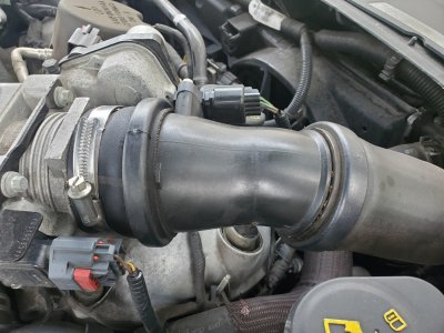

One more of the noisemaker delete641ca15f1ccc72f80502d69041433a71
2010 SHO PP, axle back exhaust, upgraded thermostat 20" summer rims wrapped in oversized Advan Sports (currently removed 3 bar MAP, iTSX tuner with 91oct tune)
There is that one and another near the firewall.
Is it possible to just replace them with BOV? I take it the oil is from not having a catch can?

They are BOVs, and yes invest in a CC. If you buy the EPP Hot Pipe you have the choice of upgrading to a single Tial BOV. The stocks ones work just fine however.
I pull this out of my CC every 3k miles. Without a CC that gets sent back into the intake tract and then baked onto the valves.
