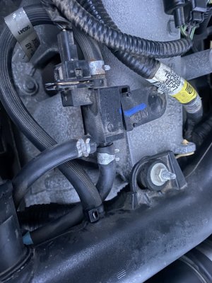

I have 2012 sho when accelerating will drop out and kick back in. It’s not a transmission issue but similar symptom. As you push down the gas pedal and begin accelerating it will lose/drop out it’s power. There are no codes thrown, ever. I’ve replaced fuel injectors, coil packs, o2 sensor, plugs, battery, alternator and had a mechanic run a full diagnostic on the computer.. nothing comes up bad or faulty. Also had the computer recalibrated. 3 mechanics have thrown their hands up to me. Can anyone help?

Check the zip tied hose at the bottom of the pic attached. That may have come off. Very common.

That boost reference hose will cause that for sure.
As well as bad torque converter... ask me how I know. I was finally able to repeat the symptoms by cruising around 45mph, let off the gas then get back on enough to make the trans kick down and I could watch the RPM’s bounce through acceleration.
