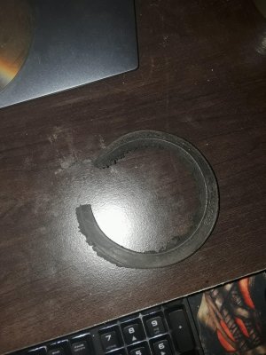

It's been a minute since I've been on here. But I just had an issue with my MKS. Tuesday morning my serpentine belt broke. I replaced the belt after making sure all the pulleys spun free, and they did. Well today on the way home from picking up the kiddo from daycare I heard a noise. A slapping like noise. Thought the belt broke again, but it was still intact. Looking over the car I noticed a piece of rubber sitting on the frame rail. It's round and appears to be possibly a damper of some sort. After fishing it out and looking at it and the car, I see it came from the AC compressor. Or at least I'm 99% sure it did as theres still a tiny piece left over on the compressor.

Engine running, it appears to spin fine, both engaged and disengaged. Best I can tell clutch operation is still functional without this rubber piece. Which I'm only assuming is a damper for noise suppression? I'm just really kind of hoping it's not used for balancing of the pulley or something.
More than likely I'll be sucking it up and ordering a new compressor and belt. Maybe a new tensioner, but dont really see that being a necessity. Hopefully work will allow me to evacuate the ac with there machine. I'd be less than happy to have to pay someone to do it, then pay again for a recharge.

The rubber is not there. Or at least if I'm seeing it right, that's the piece in my second post. It came from the compressor.

https://imgur.com/p1Xk3hv
Got it off. Omg they give you zero space to work in there. My arms and hands are torn up, but it's off. Going to grab the used one tomorrow morning and throw it on there.
Its absolutely trashed!! Just glad it lasted as long as it did. No idea how it failed, but it definitely did.

So it seems that your magnet broke off and the rubber piece was just the insulator behind it. Never seen one break like that.
