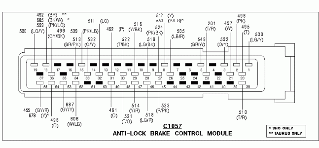

DTC 31 Open or short circuit LH front sensor, wire harness
DTC 32 Open or short circuit RH front sensor, wire harness
DTC 33 Open or short circuit RH rear sensor, wire harness
DTC 34 Open or short circuit LH rear sensor, wire
DTC 35 Open or short circuit LH front sensor, wire harness, teeth on front brake anti-lock sensor indicator, sensor air gap too small/large
DTC 36 Open or short circuit RH front sensor, wire harness, teeth on front brake anti-lock sensor indicator, sensor air gap too small/large
DTC 37 Open or short circuit RH rear sensor, wire harness, teeth on rear brake anti-lock sensor indicator, sensor air too small/large
DTC 38 Open or short circuit LH rear sensor, wire harness, teeth on rear brake anti-lock sensor indicator, sensor air too small/large

Antilock brake connector pinout 94
Antilock brake connector pinout 94 2
