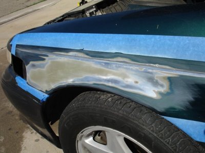

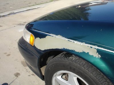

I was bored this morning.. and had some spare time, so I went out and got some paint. Since I got my '95 the driver side fender had some flakey paint, and the last few times I've washed it more would flake off.. well it was getting to the point where I had barely any paint left.. so.. I decided to make it look less nasty.
this is the flaked part..

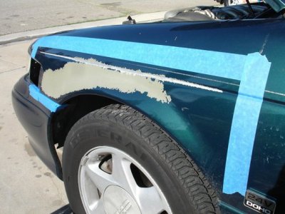

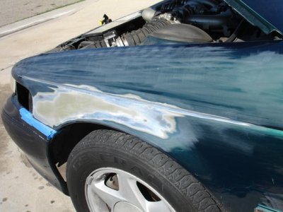

main sanding area masked off
Dsc16403
ahh yes..
Dsc16404

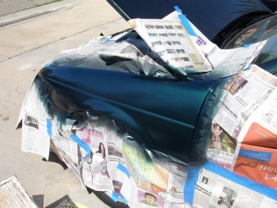

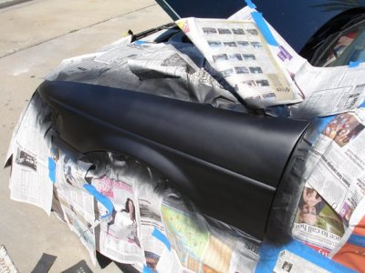

body masked off
Dsc16406

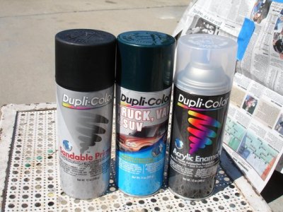

used some cheapo rattle can duplicolor..

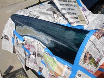

primer
Dsc16408
paint

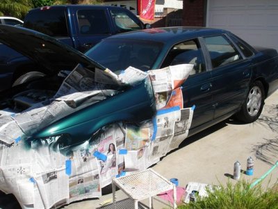

cleared..

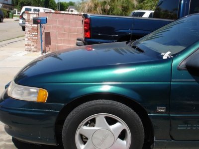

It's still drying right now, I'll go snap a pic after the masking is all off.. so.. now bad for $20 worth of paint and a few hours eh? :biggrin:

Looks pretty damn good. Jeese, i'm going to have to fight off the urge to touchup my car this weekend now.

Looks pretty freaking good. I'm planning on painting my hood soon with some duplicolor. Hopefully it turns out as good. It's all primered, and that's as far as I got. Any tips?

damn, I have never seen results that good with rattle cans before! Good work! Did you clear it after and with how many coats?

lots of paint and clear :rofl:
yes.. probably 4 coats of clear
