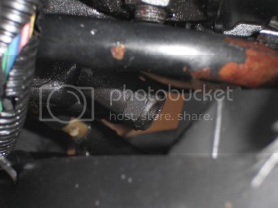

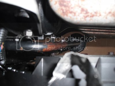

Summer just hit hard Sunday afternoon so I decided to press MAX A/C to keep the compressor running nonstop. Not even 2 minutes after doing so, I hear the sound you hear when a million beads fall on hard floor. and I see all of my A/C gas fly out from under the hood. I get home and compressor oil was all over (what a think is) the dryer, and all over the compressor. I finally get a chance to look at the car today and I cannot find a hole in the tubing or the dryer.(********* chamber is the dryer, right?)
This is an ATX a/c system btw.
I have some pics, as always
As you can see, the black paint has been ripped up by the pressure release.

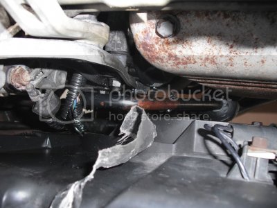

I also noticed this, I It's attached to the compressor and has big ol' hole in the middle of it. Should it be like that?

The dryer/condenser is the cylindrical item mounted to the firewall; it has a two-wire electrical connector on top of it and the low-side fill port to the passenger side of it. I don't know what the death-star looking thing down there but it isn't the dryer.
The hole in the line doesn't look good - lines generally shouldn't have holes in them.

It's not on the firewall in MTXs. It's right by the compressor...yes...in the pic above.

:nut: I don't see a hole in my lines. :nut: Circle it for me :nut:

The last picture is your pressure relief valve. It is normal. BTW I need that line for MTX if anyone has one!! (the line with the pressure relief valve)
Edit, I dont see any issues with those lines in that picture. The noise was probably your compressor taking at ****. The flaking paint is normal, those lines go from warm to cold to wet back to warm all the time so its tough on the metals.
