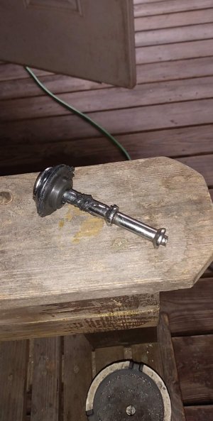

Yeh the censor thing always baffled me. So it's I believe one on the "upper" part of valve cover.closer to intake manifold side. In middle of valve cover. When it broke I just quit and haven't touched it in two days. I think I'm going to pull cover off and look to see how bad it broke in head. Here is the broken bolt. What should I do to remove it??

yeah see if there is some sticking out above the hole to get a pair of vice grips on and twist out. Otherwise you will have to try and drill it out. You can use a center punch so the bit won't walk around on you while you try and drill into the center. Then use a bolt extractor. Last time I did that-- I had to extract it and the threaded hole go mucked up and I had to helicoil the hole. You need an extra bolt or a few (used ones). Also the valve cover round seal around each bolt won't work to keep oil from leaking without being held in place by that bolt.
You are not the first. Many of us have had to deal with this. Hence the advice up front about aluminum fasteners. Good luck. You can do this.
Ok.great.thats what I was hoping I could do.tap and drill,and extractor broke bolt out. Good to know.thank you so much!!!! Yeh because I noticed also on another bolt hole the threads in head got stripped up top. But that bolt hole is one that hole is hollow(goes through head,no bottom) the other bolt holes have a bottom(like if you put a skinny pick through,it would stop at bottom) so the one that stripped doesn't have a bottom.can I drill and helicoil that,with shavings going into the engine block??? Thank you so much man!!!
