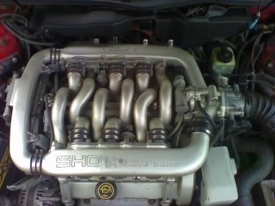

I'm voting completely separated motor mounts, I just reinforced mine a month or so ago and had this EXACT issue. Dude fix your your MM's they're more than likely the issue...
31504220025 large
Look to the right of the SHO on the Intake, if yours looks like that you know it is the MM's...
