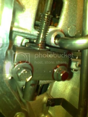

I dropped the tranny pan and filter. The fluid and the bottom of the pan looked like it was just changed yesterday. By looking at my pressure lines it looks like a line or 2 are puled back some. I can see a 1/2 inch smaller part of a tube not into the case. Not sure if this is normal or not but my TSB I have here dated 10/5/1994 Bulletin number 94-20-9 on 1993 SHO's this can happen resulting in no movement and probably no codes.
Nobody on here know if all pressure lines should be shoved into the case all the way and no smaller tube part showing?
Winterhawk
1993 SHO ATX
Aug 7, 2009
89
Independence, Missouri
100530 191034
I dropped the pan and saw this. Is it normal? The TSB says it's a radial type seal. Looks like it pulled out some. There is a little piece of plastic stuck in the smaller tapered end it looks like. TSB says lack of pressure could cause no movement.

sounds like your pump quit with no pressure or fluid flow. try unplugging the tr sensor and shift through all your gears, this operates your transmission at full line pressure. your picture looks normal thats how they are, the line extends all the way through the case into a clutch piston.

He already clearly identified the problem as being a rear **** tube that popped out....
