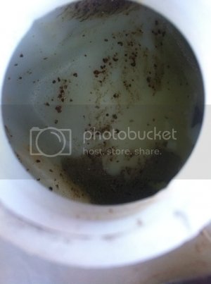

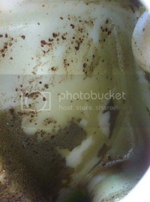

My '93 3.2L has been sounding more and more train like (think shika shika shika in relation to rpm), and the last time I drove it the heat climbed up (usually at 'a', went to 'o'). I turned the interior heat on high and the temperature immediately dropped.
Today I took a look at the coolant reservoir and saw this:
A4d81f391db23f03
Up close it almost looked like mouse droppings...
What course of action do I need to take to get all this crap out?

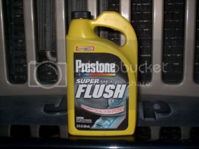

You could try something like this:
IMAG0106
Which involves replacing all of the coolant as well.
To me, that looks like course sand and aluminum filings, but it's hard to tell :shrug:.

Definitely no metal in there... The car had been stored for a few months, so I am guessing mice might have stockpiled feed in there.

That almost looks like some form of Stop-leak material. Whatever it is, get it all flushed out of there (including that overflow tank and associated hose) and replaced with a 50/50 mix of good antifreeze.
