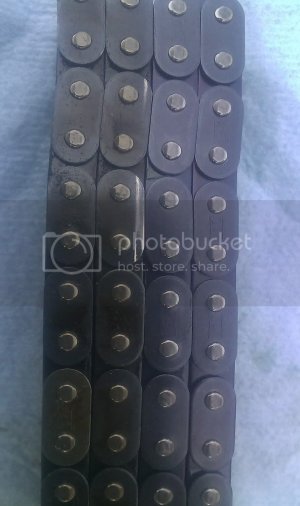

...I was wondering if this might be a sign of timing chain getting loose?
The chains are fairly short and tensioned with a hydraulic tensioner. If they were to stretch a little bit, the tensioners would pick up the slack. Due to the short length of the the chains; they would likely snap before being able to be stretched to the point of causing the car to run poorly.
So, I would rule out timing chains as the cause for poor driveability problems. I pulled a set of original chains with 140k miles on them and the only stretching they exhibited were from the pins stretching, giving them more lateral movement / slapping into the guides creating noise.
IMAG0395
Old on the left, new on the right.
Search the forums on how to pull codes using the paperclip method if you do not have a scan tool, and let us know what codes come back. There are a lot of worn parts that can be linked to the problems your having; but the best place to start is checking for codes even if the check engine light isn't on.
