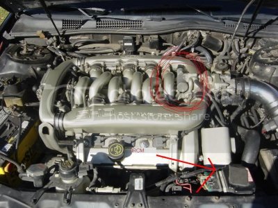

Are your cooling fans turning on all the time? meaning....do you ever notice your car running hot sometimes and sometimes not? Your IRCM also runs your cooling fans and you fuel pump. It is possible that the part of the IRCM that runs the AC could be bad.
The part on my IRCM that runs my cooling fans is bad so i just wired a switch, but its a different story for the AC.
Check all the connections on the IRCM and the wires leading to the AC compressor, If it looks good, there "should" be a little stick pad on your IRCM (the flat black thing on the radiator support bar), Peel that black sticky pad up and there will be a letter on the ircm. Mine is "M". Depending on your car make/model/year it may vary. If you decide thats the problem, then buy/find a new one.
Good Luck
EDIT:
Just in case you dont know where the IRCM is, here is a picture i quickly chopped up...Dont worry about the red circle, that was for something else, :nut:
Motor
