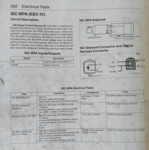

Have the 92 mtx all put back together. Now crank but no start. Have spark, fuel pressure, and compression. Getting code 551 (IAC circuit). Skeptical that this would cause no start, but pulled IAC. Checked resistance - 9.5 ohms. A friend has a comprehensive online repair manual (he is a mechanic) and looked up the test. His source says the resistance should be between 50-100 ohms. Purchased new IAC. The new one reads 9.5 ohms, as well. Seriously doubt that this is out of spec, given that new and old have same reading. Any thoughts on the proper resistance ? Other ideas for cause of no start ? Any help would be appreciated. Have come a long way, having chased AC compressor all over the country, etc. Almost there, I hope !

FWIW - both Chilton and AllData show the 551 code as IAC circuit. Further - AllData show the test being proper IAC resistance as between 50-100 ohms, as I noted above. Anyway - will check wiring, grounds, etc.

Per Probst, the resistance should be 7-13 ohms. Alldata has it wrong. You might want to run through these other tests to see why it threw a (presumably On Demand) code.
