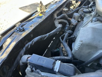

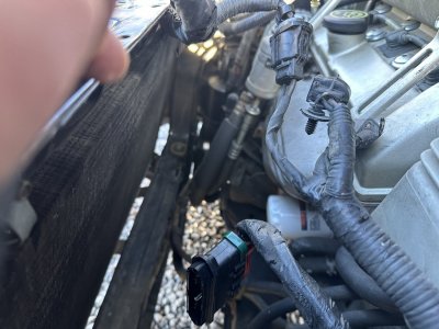

Hey what’s up guys again. Rad started seeping a bit. Anyone know of a good replacement. I seen there’s an aluminum one from radiator express are they any good or do you guys thing just a parts store replacement I have the replacement but I am kinda hesitant to throw it in if the aluminum one is better I’ll but it. Let me know guys thanks again !

Get the aluminum one on ebay. I have one in my blue 95 and my white 89 and I have a new one sitting on the shelf for my 91+. Very solid construction and 30% larger capacity! Just make sure to add a ground strap to the chassis. All I do is take some 14g wire and add eyelets to both ends and then attach one end to the radiator and the other end to the upper radiator support.

I ordered one from radiator express. I wasn’t spending a 1000 bucks on a rad. There 280 on rad express. Gotta be better than plastic end tank one. If it breaks my buddy is a master with welding aluminum we’ll see how it does, car is stock don’t really need so big huge rad in there but thanks I was on the same page for aluminum rad though
