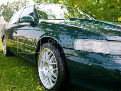

Here's a shot of 235/40/18's on an 8" wide wheel.
Orland06
Any wider and they would definitely hit my strut.

Whats the offset for those wheels John?
I'm looking to get some 245/40/18s for a set of 8" wide wheels with 37 or 38mm offset, I *think* there should be enough clearence.

Angola, Indiana
Mine have a 40mm offset. You should be ok with the added 2-3mm offset. What kinda wheels did ya find?
