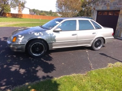

I have an 89 SHO all stock with 114k mi. Over the last year it has developed an intermittent stumbling problem. At first it was very minor and usually happened when it was cold. It has now graduated to much more frequently even well after being up to normal running temp. It doesn't matter if I'm light throttling it or WOT. When it starts happening I can slightly back off the throttle and it will go away unless I increase the throttle even a little and it comes back. There are times when I can start the car and it runs perfectly until I turn it off and restart it. I've checked the fuel pressure and it comes up to 33psi when the ignition is turned on and settles at 30 when started and idling. It will go up to about 35 when I rev it. It will hold at 30 when I put it under a load. It will hold at 30 when I turn it off. Even after 30 minutes the pressure is still 30 psi. Car usually start quickly but on occasion it will crank 10 or more times before starting. This problem comes and goes but is occurring about 75% of the time now. Any help diagnosing this will be greatly appreciated.
