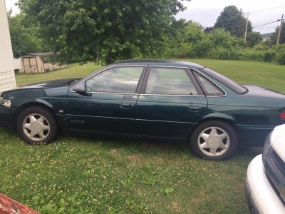

Hey guys I just purchased a 89 sho for way to cheap anyways the fuel pump is either out or I have a bad relay or fuse but I cannot find the relay for it and have followed the wires and found the ecc spot and that's it anyone have an idea or should I just change the pump??? And it is not the inertia switch unless it has gone bad because the trunk has had a water leak so it is possible

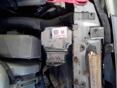

The relay is in the CCRM constant control relay module. Black box with wiring plug going into it above the radiator. Should have a letter on top like J or M. Should be under a plastic thing over the radiator area on the right side. Can't tell you if the relay or pump is out

If it was this box I would assume other problems as well I have a fuel pump here I am going to try and then if not that then the box thanks i appreciate it Aa698f2393e70639e05b3db9af1e95fe

Yes not bad paid 400$ for it it has some issues but instead of the initial idea of a restoration I'm going to do a track build

I've had a bad fuel pump relay in the CCRM. but thats not as common as the fuel pump...

The wire is pink with black strip going out of the relay, make sure its got voltage. That year I believe has dual voltages for the fuel pump. See that horseshoe white looking thing in the back, that's the resistor for the fuel pump in low mode. bypassing that wire keeps it in high mode. No voltage at all, its that relay. If voltage and fuel pump is dead, then you have to cut a hole under the rear seat on right side to access it.

I usually drop the tank I actually had the tank dropped when I realized I should be doing voltage test first and lucky for me I ended up just finding a loose wire reconnected it solid and it started right up like a dream now I have a small crack in the radiator and my fan isn't working I'll probably rewire the fan and replace the radiator with something nice then I got to jump into the wiring behind the dash because my temperature gauge is not working
