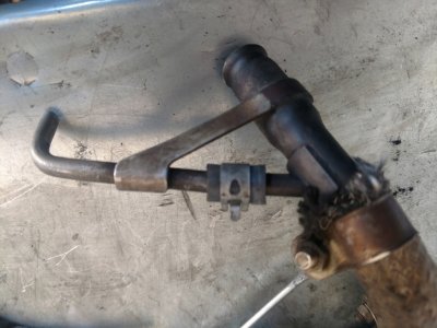

Next up is to check the bellows at the bottom of the EGR tube. I've had many cases where they have split. They can't be tig welded because the metal gets too thin. You could try plugging the hole with muffler mender and putting a hose clamp over the repair to keep it in place. Failing that, my Mickey Mouse solution is to delete the bellows and use a 1/2" ID galvanized steel pipe from the plumbing section of a hardware store and stuff it into a length of 600 degree 5/8" silicone hose from http://www.turbohoses.com. Lasts for about a year before the four hose clamps get loose and need retightening. Often but not always I replace the hose as well.
