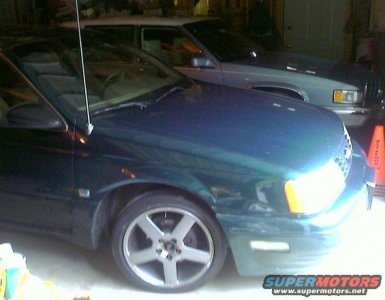

I had a set and sold them. They are 5 x108 but there's something about the Volvo wheel being lug centric and SHO being hub centric that makes torqueing them down carefully important. Tires in pic were Volvo size, 205/35/17 I think - way too small for the SHO. The wheel is HEAVY! About 25 lbs per and I wasn't as excited about the looks once I got it bolted on.=
91 t5r wheel

I think that wheel would be more fitting on a Gen II.

SHOSpazz is right. Gen II could look good but they just didn't feel right on the 91. Was disappointed too as I got the wheels free and had always wanted them a decade ago for my original 91. Sticking with my five spoke Fittipaldis (made by OZ) that came on the car and going to do a little paintwork to make them stand out.

Correct, those are titans. The design was later called Pegasus when it became used on more of the Volvo line up.
