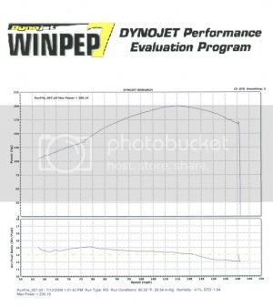

Been running a T-bird MAF for over a year, only thing I've noticed is that it runs a bit rich due to the higher flow and sample tube size.
True it should be tuned, but it doesnt have to be. Running slightly rich wont hurt anything but your wallet at fill-up time.

Because it could be reading your air flow improperly, running you too lean and **** your engine. Not saying its going to happen, not saying the chances are even substantial, but it could happen, not a risk most want to take.

Well if it makes the OP feel any better, Here is my car WITH 70mm T-bird MAF Body with the stock SHO MAF sensor in it on the dyno.... A/F graph is at the bottom.
