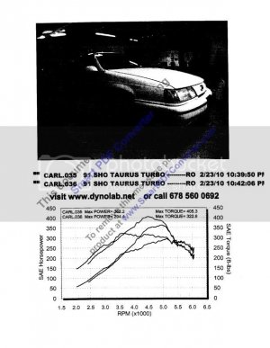

Dyno numbers are stupid.
RegierDyno 0001
Lower set of numbers are done at 10psi. The high numbers are 18psi.

is the crank or wheel HP?
what compression ratio?
can you explain why the engine falls so sharply after 5000 rpm?

It's a smallish turbo... They tend to run out of steam when you wring out a high revving motor.
That's the power and torque to the wheels. The picture is the car sitting on the dyno.
The compression ratio is 9:1 with forged pistons.
The power falls off because the exhaust simply can't get thru the housing. To make more power, it'll need a bigger exhaust housing, but that will effect drivablity and delay the power.
