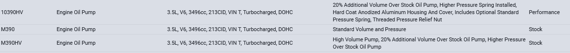

oil pumps have not failed on any 3.5 cyclone based blocks that i am aware of, or if they have, failures are EXTREMELY rare. couldnt hurt to put in a new one once you are in there tho, keep the old one if you have room at home.
now livernois did build a custom part to improve oil flow for @bpd1151, idk how well it works, one off that i can recall.
fits a wide variety of applications, naturally asp or turbocharged
if you want to upgrade the pump. but unless you are heavily power added, i dont see a reason for it.

I'd agree. A high volume, high pressure pump may be a band aid fix.

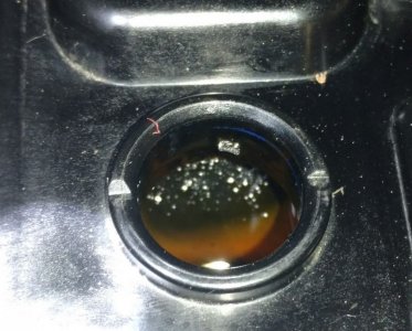

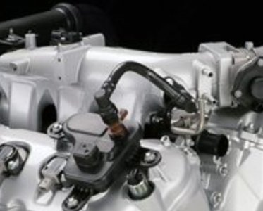

Check the PCV valve oil separator passenger back side on engine. Pull the valve get a flash light and look for oil pooling. See stolen pics fr9m xpost. Also others discussed the CAC. Remove the plastic cac hose from TB. Check for oil pooling in the CAC. Also Ford recommends not changing the weight of the oil or adding additives. I state this to say one item. You could be complicating the condition. It also sounds that a mechanic or last owner might of f'd things up. Going back to Ford standard weight with proper filter, etc etc... mixing things up and chasing issues while not keeping to Ford specs can add to the problems. I say this non judgementaly...
Make sure to CAC pipes are not drowning in oil. It is normal for there to be some oil, however look for caked up oil and pooling @Junkyard_Mad-Scientist

I will definitely be looking in to that, during my oil change I pulled the intake tube off the tb and noticed a little line of oil, unsure of how it got there I cleaned it and ignored it, after an hour test drive of varying driving styles the light has stayed off. I plan to check these spots you've shown here and drive it, next oil change if it behaves and I don't find anything else I'll go back to Ford spec oil, the oil I put in was more of a test than anything, but I'm still planning on checking the actual pressure with a Guage too. More to come soon, thank you for your help
