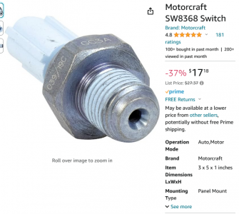

Little update on my own situation. A seemingly easy to obtain sensor is becoming difficult to hunt down. People keep saying they have it only to say nevermind have to order it, even the people I ordered it online from (Amazon seller) said they have to order it so it went from next day to next week, beyond my lift window. So now I'm calling dealers in the morning but when I crossed the part number I had 2 come back, what part number to I need? I had ordered Motorcraft SW 8368 but ford's website shows that one plus one other one, one labeled switch and one labeled sender. They look identical and both say "also called switch" or "also called sender". Gonna pick the ford guys brain bit does any one know?

SW8368 is the correct sender. It is used on many vehicles for many years. Should not be hard to find. Standard Motor Products PS427 will also work.

Update: got a really helpful parts guy at ford and between our two heads we figured out that this switch has had 2 revisions. SW8368 comes back as the most recent and correct one for the car. And for anyone that knows ford part numbers the ford part number ends in B signifying a ford revision to the part. Unfortunately there were no notes as to why it was revised specifically or when the revision happened. Amazon wants $21 ford wants $66 but I can have it today. I'll update again after it's replaced

Rock auto has the oil pressure switch, Motorcraft SW8368 for $17.48
I have a buddy letting me use his lift this weekend so I was trying to get it for today, I'm 2 weeks out of abdominal surgery so bending and crawling are kind of out of the question, i figured a lift might help with my limited mobility. Found a ford dealer with it in stock for $32 so I'm just gonna eat the extra cost
