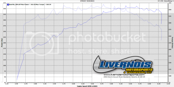

Just curious what you all would think my horsepower/tq is with Livernois 93 oct Tune 3 map, windstorm CAI, livernois downpipes, and upgraded thermostat. I would just like to know where I am at, I have been told with full bolt on we should have around 500 HP, how close should I be wih what I have and what else can I do (other than full exhaust, I like being a sleeper) to maximize what I have.

375ish is a solid guess.
Here are 2 2015 cars that have:
V10 tuning
Windstorm CAI
EvenFlo 160° tstat
and 3BAR
1520SHO20level201 zpspkadd24h

So if my math is right somewhere right around 500 at the crank? I was figuring 25% loss from AWD

We do not subscribe to the guessing game that is bhp. There is no way to verify what the engine output is without ripping everything out and testing it. Stick to wheel power. Even if it is only an educated estimate it is far more accurate than,"I think, I make like 490bhp.":thumb:

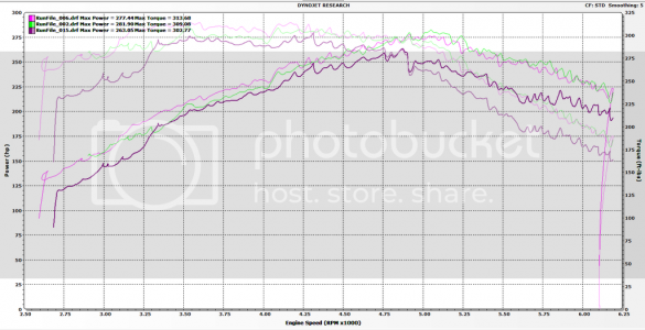

Do you have comaprison charts

Do you have the dyno numbers for these cars, or similar SHO's, in stock form? I would like to compare the peak numbers as well as powerband. Thanks.

Thanks. I aligned and over-layed the charts. The power gains are impressive. Where are they coming from primarily? Boost pressure?

The gains come almost exclusively from recalibrating the power creation and application logic in your car's ECM. As we have proven many times simply cranking up the boost pressures will actually result in a net loss of power, and likely result in failure. We typically keep boost with ~2% of stock, and rely upon our experience and superior software to force the car to operate within its most efficient parameters. This is why we make more power, we have the most reliable, repeatable and safest tuning available. Long story short it is the secret sauce that makes it so great :cool:
