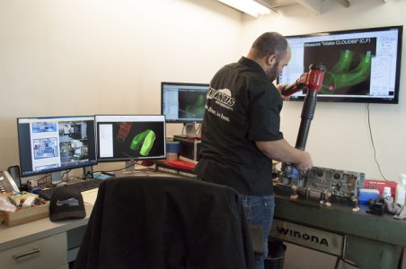

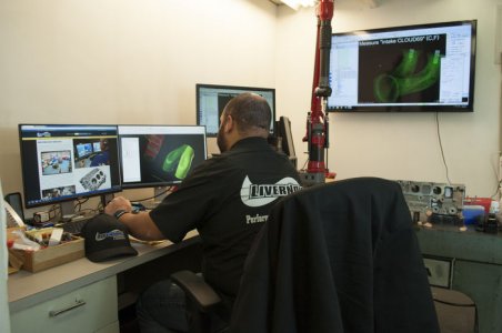

Good question!
So if you actually look at our Machine Shop Services you will see that we have a tool that you have likely never even seen before, a ROMER Infinite 2.0. The ROAMER can be affixed with several differently styled tools for different types of measuring, probing and/or digitizing. What this tool allows us to do is actually use its arm to take data points, log those points, reproduce them into a matrix and then recreate that part into a completely manipulatable 3D image.
Ex q80 w700 h images DSC 0758
So once we have all of those points transformed into a viewable/manipulatable image we can then sit down and review that recreated matrix. This allows us to take measurements on all 5-axis'. Using all of those measurements we can use our MasterCam X7 with Port Expert, Solidworks 2012, Camplete port and Verisurf X softwares to engineer a deck brace.

Actually, I watched my first Roamer demonstration before the guy in this photo was born, and agree they are an impressive CMM. (Computerized measuring machine) There are many, and this one is low priced, convenient, and efficient.
Now, the deck plate- Is it the outer surface machined to fit perfectly into the water jacket? Does it allow for the draft angle built into the water jacket by creating a solid cad model, which is then used by a CNC (computerized Numerical control) to machine a custom deck plate for each block? I think it would be easier and more productive to first machine the block to a given depth from the head face, using a cutterpath written to accomodate a perfect fit for a pre-manufactured deck plate. Make all the plates the same size (one for the left bank and one for the right bank) Then, just drop the deck plate in.
My real question is: how do you hold the new deck plate down in it's opening? Of course, the head would hold it down, but for it to fit tightly around the bores, it would have to fit with a micron-measured tolerance.
Not trying to be a Poindexter, just trying to understand how this baby will keep my bores from 'dancing around' in the water jacket.

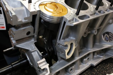

Seeing how the ROMER did not sell their measuring tools in the US until 1989, I would have to say that the 30 year old pictured is a tad bit older. Furthermore, the INFINITE 2.0 was not released until 2008. Just being a stickler for chronology. Especially since the guy you mention in the picture happens to be me. :thumb: The complete INFINITE 2.0 system (without probing tools) is also quite expensive. As they typically have a starting price of ~$30,000.
The entire piece is machined to match the spacing of your particular deck to perfection. We have actually tried to install the deck brace similarly to how you described. The problem is that you cannot make the braces to the same stringent tolerances that we do currently if we were to make them your way. This would eliminate much of the structural integrity of the brace. Post machining the brace we actually have developed a proprietary process for pressing the brace into place. This process is very similar to the one that we use when installing our proprietary sleeves.
Mg4 0327
The brace adds significant strength to the block, deck and bores. This ensures that even under high boost conditions where power and load go up considerably, that the bores don't shift and move due to the factory open deck design. In addition, to strengthening the bores and improving ring seal under load the brace also improves the head gasket retention and sealing, preventing gasket blowout. This brace kit offers a much needed improvement in bore and deck strength for the EcoBoost 3.5L engine. The factory open deck block architecture works well at OEM power levels, but can quickly become strained in higher boost and power applications. This bore brace adds significant rigidity to the bore and deck. This allows for much higher output without fear of failure from bore deformation or gasket blowout. The increased strength of the deck surface prevents gasket creep and eventual blowout. The design of the brace with its integral cooling passages built in allows to maintain the proper gasket temperature as well, and also allows for coolant passage between the cylinders. Livernois offers this system with included machine work necessary to upgrade your 3.5L EcoBoost engine to the ultimate in durability and performance.
Mg4 0327
