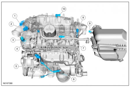

Question 1: Is it true that the SHO 3.5L engine does not have a MAF sensor and in its place, it has 2 MAP sensors. And if this is true can someone describe where to find them.

NO. 1: No MAF. MAP sensors before the throttle body and on top of the intake. 2 and 10 in the picture.
