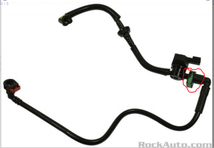

  • I have cleaned the fuel inlet, I disconnected the power and the circled side of the evap purge valve and there was no suction at the valve with engine running.
ZqMGyTx

With the check gas cap warning, the pcm is detecting a VERY LARGE evap leak. I would send you to the rear of the car to make sure the vent valve can hold a vacuum in the system in addition to confirming the fuel tank pressure sensor is working properly. Making sure it reads atmospheric pressure with the system open.

The purge valve is pulling air through the evap system and the vent is open. I wouldn't say that the pressure being 0 is bad if the vent valve isn't commanded close.
