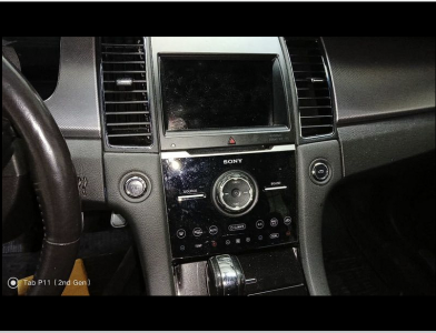

Front Console, have fun
Also try under interior on the top menu
