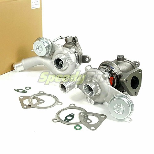

I took my 2012 MKS Ecoboost in to the shop on an underboost code, and lo and behold, both turbos need replaced. Shop quoted $6,000, which seems super high to me. I've read that replacing the turbos is challenging, but doable. I found some replacement turbos online, but I question their legitimacy:
Are these OEM or some knockoff?
I was also recommended to replace the intake hoses due to oil contamination. Where can I find those (or other replacement parts)?
Is there a not-over-$3000 option for aftermarket stuff here? Any Help would be greatly appreciated :)
