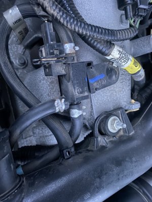

So my MKS Ecoboost lacks any sort of power you'd expect from a 3.5 TT. I used an OBD data logger to find out why, here's what I found:
1. Boost pressure will never exceed 0 PSI
2. Wastegate Duty cycle: on first attempt to launch the car upon start up, WGDC will increase as expected up to 100%, then underboost will trigger, and WGDC will never go past 0.
I hear the turbos spooling, so is it a boost leak??

check the hoses connected to the wastegate controller, located atop the manifold. ford doesnt clamp them, dont know if lincolns are the same or not.
unusual to see 2 turbos fail together, but check the c-clips on the wastegate actuator rods on the turbos.

I had previously checked that and it seemed snug enough. Added a zip tie to be sure and problem persists!
I'm taking it in to a trusted mechanic on Monday (tomorrow), see if they can dig up the issue
