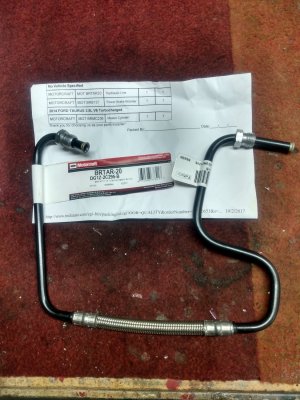

I have a 2010 Taurus show with PP. The brakes have never been very good even when I switch to wilwoods on the front but I think the main problem is the master cylinder. I'm going to replace it with the 2013 master cylinder and vacuum booster. I checked into this a while back and also purchase the brake line required for this upgrade. Has anybody done this upgrade? Anything I should know before heading in to it?
