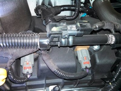

Not really sure about composite valve covers. How will I know?
