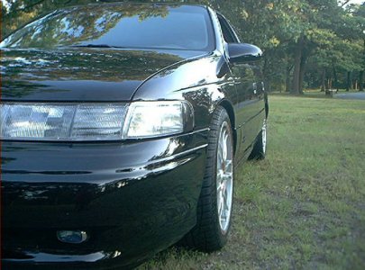

If you were to go with a 40mm offset and that 8" width(235mm tire) it would look like this(width wise):
Sho35
Anything more and will fit but cosmetically wouldnt look pleasing, from what I see in that auction you'll 19's cheaper than I paid for my damn 18's on my old SHO good find. I also agree with you about everyone else buying 17's or "upgrading" to slicers and t-bird wheels, my 18's were to be different back 2yrs ago and just like your doing, this summer my SHO will roll on 19's.
BTW here's a Gen III SHO on 20's(bad choice of rims IMO)
