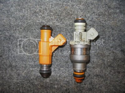

No, he's not sure since he's dead wrong... :shakeheadYou sure they have the V8 injectors? The V8 injectors are 12mm shorter than the normal Mustang ones that I've seen.4.6 OHC (mustang-cougar-tbird) has these. At least in the early versions of the 4.6.
The injectors also fit my wife's 2000 model 2.0 SOHC Focus
Would these ones work?
If so, I feel one would have to be putting down ALOT of power to require them.
