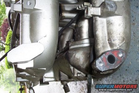

SHO Type U said:
The only time this is true is, if its a California SHO, all California mtx SHOs has egr valves. All '93-'95 atx SHOs has egrs as well.
Like so.
Difference 95 91 cali intakes
