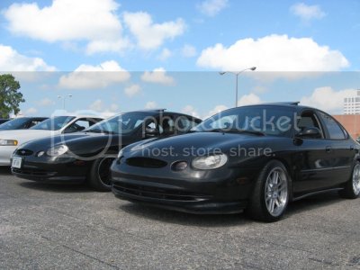

Terry (nc89sho - i think) had some on his when he sold it to Zach (zach442802983740982 cant remember numerical sequence :p ).
IMG 1459
Hmmm there were three times as many pictures from that meet in my photobucket album, now they're gone - weird. Oh well, guess that's the only picture I have now :(

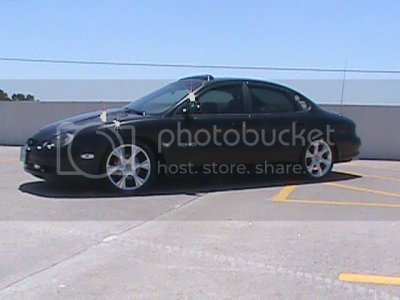

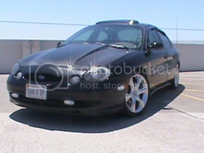

Had 18s on my '97 with 235/40ZR18 tires. Rode rough as crap. Probably had to do with the low profile tire and Rousch lowering springs. Looked sweet though.

The reason I moved back to the OEM wheels and tire size was because of ride quality. The suspension was not designed to be able to compensate for the lack of compliance in modern, very low sidewall tires with their extreme stiffness, particularly when combining that with other suspension modifications that provide more stiffness elsewhere in the suspension and frame.
pax, smn
Yeah, I don't know why in the world I put "probably" in my post. I have over a decade in automotive modifying, especially in the suspension department. It should have read "It has to do with the lo-pro tires and lowering kit"....:banghd: You are absolutely right Stephen.
