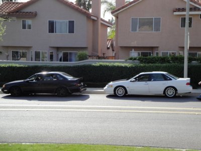

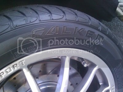

Here are a few pics of the wheels and tires. The pics were taking from my phone so they're not so great.

Here are some better pics.
Don't mind the dirty car, I am still putting it back together since it came back from the body shop.
