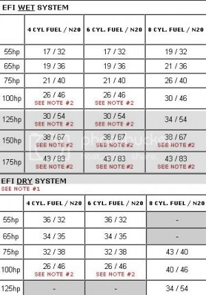

whats the most thats safe to spray dry thru a 3.0 mtx
A dry shot. 55-75 on a stock motor. you can go to a 100 shot with a bigger pump like a walbro 155lph. Zex part number #82011
whiteguy3
Scott MacIntire
Jun 18, 2007
799
91
Silver Spring, MD
100 shot is fine on the stock fuel system. You do not need an FPR or bigger fuel pump. Copper plugs and some timing removed will do the trick.
