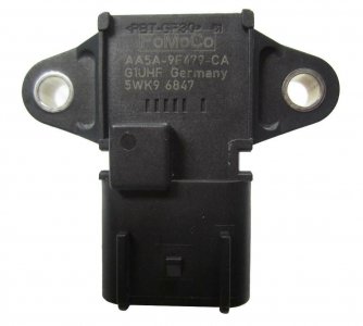

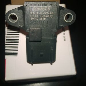

I have the code aa5a-9f479-ab So I guess I have a 2 bar
My guess would be that you're not tuned as nearly everyone who tunes also gets a 3 bar sensor. Before taking it to the dealer to see if they can flash a stock tune I would see if they can hook up the car to see if it's on a stock tune or not.

Well it definitely has a tune. It would not run with a 3 bar installed unless it was tuned for it. It would be interesting to know whose tune it is but there is likely no way to find out unless you can speak to the previous owner. If you have a dealer return it to stock, you will need to replace that 3 bar with a 2 bar.

I talked to the dealer and it was tuned, it doesn't have the colder thermostat, but the map is 3bar as has been said
The car is clearly not running right so I need to get something that can figure out why.
The service manager said if I bring it back here for service they will work with the warranty people to make sure it's honored. The finance manager who sold me the warranty just assured me it's no issue.
According to the dealer the car has a livernois intake a high flow exhaust including the cats,colder plugs and a 3 bar MAP. The only thing missing is the TSTAT. If I don't need to go stock I'm thinking about going with unleashed so that I can data log and the 200$ price difference
