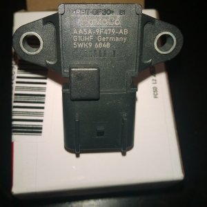

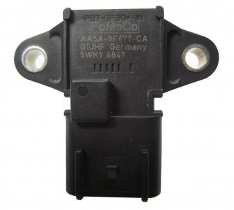

Part number stamped on it will be different. In the aftermarket, the 2 bar (stock on the SHO) is CX2228, the 3 bar is CX2231. If you have the 3 bar, the OEM part number will be AA5Z-9F479-B or AA5Z-9F479-AB.
GXPeqUb
The 2 bar CX2228 looks like this
S l1600
I have the code aa5a-9f479-ab So I guess I have a 2 bar
