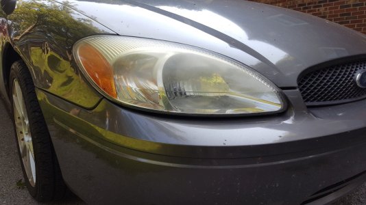

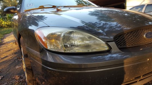

Sand them down(400, 800, 1500, 2000, 3000) and then polish them with a cutting compound. I like Meguiar's Ultimate Compound. Once you sand them you only need to polish a few times a year to maintain.
Or you can sand them up to 800 and then spray them with a 2K clear. The 2K will last a long time without maintenance but it's costly stuff with a shelf life.
