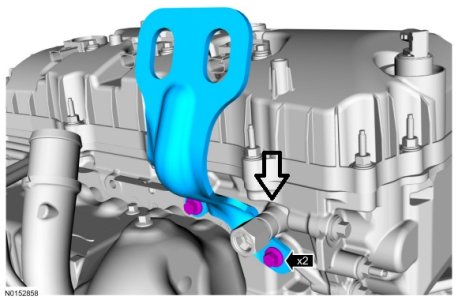

Hey guys so I kinda of F’d up on installing rear turbo I had the entire thing in and went to thread the oil feed tube line into block and it broke off in there. I was able to get it out but now I’m questioning if I’m going into the right hole. There are a ton on spots with holes on back side on block to hold brackets and what not but mine are all currently out with doing all this work at once. Does anyone have a picture of where it feeds into the block for rear turbo. I don’t want to drop the ball a second time.

Here's a used engine on eBay that shows the location. Just to the right of the engine lift bracket.
