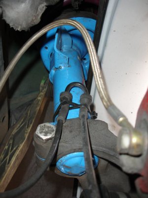

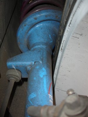

17x7 with a 45mm offset is not going to work on a Gen III is it.
It should work..
I had a set of 17.7s with a 35mm offset, they of course worked.. .
now I have 19x7.5" wide wheel with a 42mm offset and they still clear the strut. Your offset will bring the wheel 3mm closer, but the width will take it 12.7mm away, so you'll still theoretically have 10mm more then mine.
Here's the clearance on mine now..
