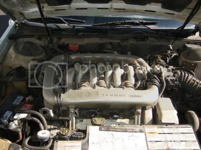

Maybe some of you guys here in my home state have some advice for me? Please see below. Appreciate all the help. ICEMAN007
Hey everyone, I just bought my third SHO and after my last one, which was an automatic and delt with tranny issues all the time, it was time for another MTX. I just bought the car yesterday, a white 1993 manual 3.0 and I am having serious issues with the car when I start it up. The engine light is not on but has came on temporarily and then goes away. But in the morning, when I first start her up, she is fine at idle. But as soon as I give it a little gas, she bogs out heavily. The more I drive it after starting it up for the first time of the day, I seem to get the "bugs" out of her and the better it seems to get and the less it bogs out. BUT, no matter how long during the day I drive it, if I push the pedal down to the floor, she completely bogs out and the car starts to sparaticaly pull and the car is shifting back and forth. Due to lack of funds right now, I am looking for your guys opinions on whats going on? Otherwise I would just take it in right now and pay the $90 engine diagnostic. I mean, I suppose it could be a few things. Maybe a bad o2 sensor, bad plugs and/or wires, bad fuel injector(s), bad fuel pump or even maybe the fuel filter. If anyone could give me any insight to this major issue I am having, it would be greatly appreciated! Thanks, ICEMAN007

First thing i would check is fuel pressure. Low pressure will cause a bogging sensation at WOT and higher rpm speeds. Also, pull the codes and let us know what errors come up. That will give us a better idea of what might be going on.

111= all tests pass (I guess that's stored codes if you ran the KOEO test)
172=HEGO sensor circuit indicates lean. (Rear Side)
176=HEGO sensor circuit indicates lean. (Front Side)
211=PIP circuit failure. (camshaft sensor)
219=Spark timing defaulted to 10 degrees, spark output circuit open.
542=Fuel pump circuit open, EEC processor to motor ground.
Holy crap man, I don't even know where to start. Looks like your car has electrical issues. Your cam sensor is bad, your SPOUT circuit is, for some reason, open. I would start checking wiring harnesses for cut/chafed wires, looks like a few got cut. I would start at the computer and work my way out. Good luck...
You may also have a bad throttle position sensor (TPS).

I wouldn't head out to buy O2's just yet... don't rule out a vacuum leak. The stock intake couplers are notorious for cracking, and allowing un-metered air into the motor(lean condition=no power).
I'd grab a propane torch and check for vac leaks on the intake. Just run the propane torch around the intake and listen for any noticable idle changes. This of course, with the torch not on (no flame).
That's not to say that your O2's are not on their way out though...
