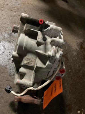

Found one out of a 2018 SHO with the performance package. Has 55k on it. Seems cheap enough so might grab it.

Think I should be concerned with the oily look around the vent tube?View attachment 89518
What year did it come out of, all I can say drain and clean that oil - even buy extra gear oil, and drain out the drained fluid. Get all the metal out of that before putting it back in. I have many threads where certain year would clog - the vent tube would become clogged and allow for pressure to build up. Start searching threads here, many recent posts tbh.
Came out of a 2018.
