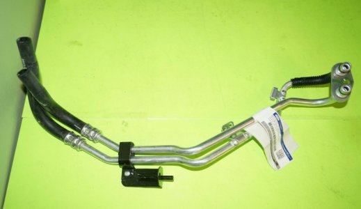

Honestly, don't think I'm going to touch it. Just change fluid every oil change. Thought about routing it in line with my trans cooling though lol
Ah, ok, if you're not using it, that cooler housing on the side is removable. There's nothing underneath but the side of the case.
But if you were going to convert it or add in your own cooler, all you'd need to start with is this OEM part.
Bdef4a067d2b7a895750d82a3d87ac48
You could trim it and put AN fittings kn the ends to make it fit whatever you wanted....but you'd also need some sort of pump to circulate it.
Why I was thinking using the trans to cool it could be a smart method. If I were to tie it into my trucool trans cooler I'm going to put in the car I would just have to run the lines to and from

Thinking about it more I'm going to try the trans cooler idea. Trans fluid out to cooler, cooled fluid to ptu and then back to trans. Can estimate the ptu temperature with the trans temp pid. Certainly can't hurt to try it out. The trucool cooler I have is pretty big so I figure I'll keep up just fine
