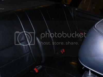

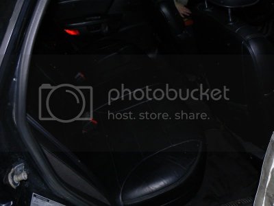

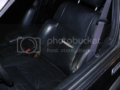

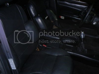

:( Gotta get that stitched, and the bolster fixed. Only sore spot inside. :( They sure are soaking up the conditioner too!
Eric VerValin
PiMPSKiLLET
Mar 28, 2005
3,187
649
Fort Wayne, Indiana

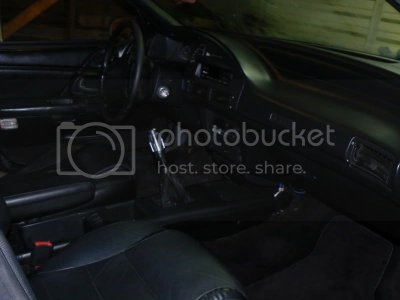

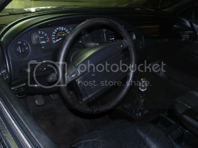

Well, some gentle dish soap and a few terry cloth like wax applicators. Then some meguiars leather cleaner. Now I've been putting on some meguiars conditioner, but I'm not really picking anything up. :) In the front, its soaking it up like a sponge now. Trying to do it a little at a time so it gets in there evenly. The biggest thing that saved me was my tint I'm sure, I was pretty suprised its come out this good so far.
And yea, thats an old shift ****. Lights up blue. Was for my lazy travels when I had to drive for work a lot. Shifter is kinda long with it on there.. lol Still shorter than the one in my truck tho. :)

I use diluted simple green and a tooth brush to get all of the dirt out of the leather. When you gently do circle strokes on the leather with the tooth brush, it pulls the grime from out of the creases in teh leather. When this happens, the creases become smaller and some disappear. I then soak the leather in a Maguire's leather conditioner for a good 15 minutes and massage it in with my hands. Wipe the rest off and enjoy clean leather!

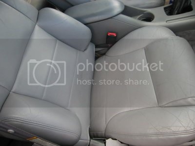

That is the front seats in my MTX. It has a bit over 150k as i type this. Thats what it looked after my little weekend cleaning. :)
Great looking black interior tho! I want it!

Dang looks nice for original. I got 181 on mine, and I think the split has a lot to do with it sitting for a year outside. :( Didnt' help the paint at all thats for sure.
