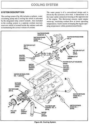

I got a reman cardone store-branded water pump, which I was lucky enough to find locally, and it doesn't come with the pump body to block o-ring gasket - it is just the front of the pump. They also had a new pump with body that comes with all o-rings including crossover tube (which I just did from the other side) for twice the money. They were willing to show me the ring, but couldn't match it at that store with other o-rings.
Called dealer, OBSOLETE, no dealers have it in stock, part number E9DZ-8513-B. Forum threads from ~5-10 years ago were "you should be able to get it at about any dealer". THANKS FORD!
Felpro gasket set ES70425 - I can't find any parts places locally that don't have to special order it (which I could do online myself).
Does anybody have a line on a place to get this in Portland OR or a chain store that would the ring or felpro kit in stock? Any exact specs so it could be matched?
Can the front of the pump be replaced without disturbing this o-ring? It looks like no.

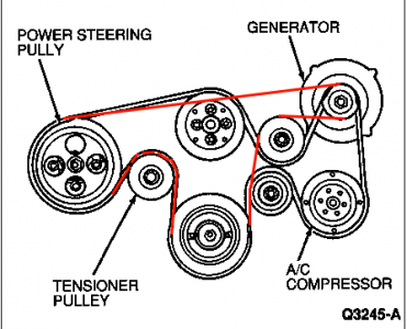

Unfortunately my SHO is mobility-limited, so I have to borrow a car and plan the trip, since it's making an awful metal squeal like a really bad pulley, but from either the water pump or the power steering (as I swapped all the idler pulleys hoping for the easy fix). No pump housing in-hand where I could just take it to a place and say "give me an o-ring that fits in this groove", it's still in the car until I source the part.
The power steering pump turns normally by hand, while the water pump has a bit of a rubby hand-feel to it when turning. I'm actually praying for water pump. Thankfully the squeal is gone with the accessory serpentine belt removed. I think I figured out a way I could wrap a shorter belt, and bypass the water pump after removing it's pulley, just to diagnose which one is dying.

I did the belt bypass like I drew above, with a 70" belt, the water pump pulley removed, and the lower idler pulley removed also, and I still got the rollsy-pollsy squeal. It's the power steering pump, and of course "Sorry, no stores in your area were found with this item available."
