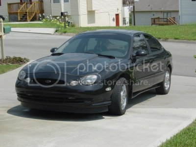

to lower underhood temps.
Today was day 1.
I noticed a 15 deg. F drop in temps.
If the temps get way up (sitting at idle/ stop and go), a short mild sprint down the road cools things off quickly and nicely.
Highway: 125 deg. stock
110 deg. cowl
Stop and go: 140-155 deg stock
125-140 deg. cowl
Normally, in heavy stop and go traffic, the temp readout would read "HIGH" (it wouldn't read above 159 degrees). Today in heavy stop and go, it stayed well below that.

LOOKS FRICKIN'''' awesome.
I always wanted a black gen 3, still love my red one, but when I graduate, december, I will be getting a black one.
Oh, wow. Im like a little schoolgirl. Geeze. That is sooooo cool.
Any chance on getting a picture from the side, Im interested in how it looks from that angle.
The carbon fiber isnt painted, right?
I love that too, from a distance away it probably looks stock, then up close, its like, wow, holy mosses, thats carbon fiber.

Nice! That hood is actually very subtle in styling and fits the car's lines very nicely. :thumb:
I'm wondering if you should look into swapping the driver side wiper arm w/ the passenger side. It seems that the air deflector might no longer be needed on the driver side. :shrug:

I gotta say, it looks schweeet! :thumb: I didn't follow this GB, but were these hoods custom made, or are they a stock item?
Also, how do you think this hood affects aerodynamics?

:biggrin: thanks for the compliments.
Get this: This morning, I get in my car to go to work. Ambient temp is 67 deg. F. The underhood temp is 83 before I start the car in my garage. (Temp sensor is placed on top of the maf tube) I drive 15 miles to work (all highway), the underhood temp stayed at 81-83 degrees the whole time!! I would have gotten ~105 deg. F with the stock hood.
I am optimistcally thinking this is keeping the tranny temps down as well. Yesterday, it didn't get above 180 deg. while I was driving around town running errands. I'm thinking it MIGHT have normally read 195 deg...
Wess, the hoods were made from a mold the manufacturer designed. Contact Alex... he will gladly set you up.
Marty, this hood fits UNBELIEVABLY well... I have no complaints :biggrin: I did have to lower the latch that is attached to the rad. support...
Mr. SHO, I was thinking the same thing :)
Brian, you are correct. The hood is NOT painted.

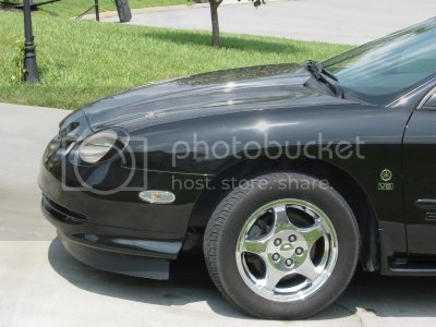

Here is a pic from the side:

That side view pic says it all..... Beautiful!!!!!!!
Hey David, where did you get those neat Yamaha emblems and what did you use to black out your headlight trim?

Marty, I got the yamaha badges off ebay. The headlight trim was done the same time and with the same material as the windshield banner (vinyl). I got the idea from Paul (SHOZ123) :thumb:
